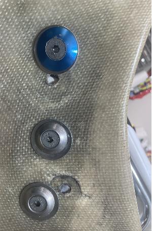

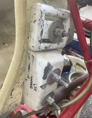

weights1New requirements for weights starting SPRING 4 (March 30, 2024) and as part of your regular kart setup for any track time:
  • Weights painted white
  • Marked with kart #
  • Secured with 5/16" bolts (1 bolt for under 7 lbs, 2 bolds for 7+ lbs)
  • Double nutted or drilled bolt safety-wired / cotter pinned
  • Secured with a 35mm washer on the inside of the seat and the outside of the weight
Karts will not be permitted on the track if they are not in compliance. We appreciate your help enforcing this for the safety of everyone. If a weight falls off a kart during a race, it will result in a DQ for the event.
